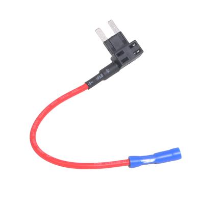

First question: what's the consensus on using splice connectors for wiring? I need to power the PLX unit and I'm thinking about just splicing into the cigarette plug wiring.

I have used splice connectors a lot when i installed alarm systems in various vehicles. It is a hell of a lot better and not to mention safer than splicong the wire and using electrical tape and even soldering.
-Anthony
Are talking about these splice connectors? If so those are the ones i would def reccomend.

If it's better than soldering that's all I need to hear--and yes those are the connectors I'm referring to. I'll pick some up to have on hand.

I'd go with an "add a fuse" style vs. the splice connector. I did this for my hardwired radar detector and will be doing it for my VBG1. They aren't the cheapest option but I prefer the option of separate fuses. I think NAPA had them for like $20 for the mini bus style fuse locally but it inlcudes a handful of fuses as well. If you buy with the VBG1 he has them cheaper and they can be found online for much much less as well.
I used one of these for my previous UEGO install. It worked fine for sure, but since I'm coming in on the passenger side I'd like to avoid passing unnecessary wires all the way across the car. I guess I can consider coming in on the driver-side again, but I'm leaning towards passenger.
FWIW, I've actually found that advance has those add-a-fuses for the cheapest, even compared to amazon.

Oh and the vampire tap mentioned earlier is not better than soldering
I'd go driver side on the VBG1 since that's where your display will be (less wiring overall I'd think. I don't have Advance here Napa, O'reilly's and Autozone are the bigger ones and we have a regional chain called Baxter's.

Even with the add-a-fuse I'd clip off that butt connector and solder that as well... solder and shrink-wrap rules for continuity and durability if done correctly.
