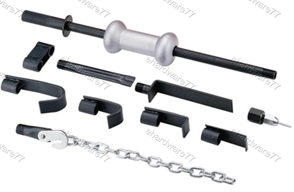

doesnt the whole front come off for that support? if its not too bent, get a slap hammer and straighten it out without taking everything apart.
