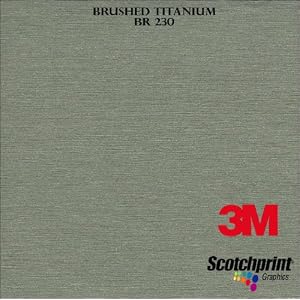

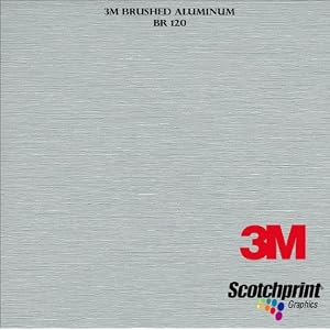

Inspired by ArcTec34's matte black vinyl wrap, I started checking out some options... Matte black had already started to get played out (although I still love it), so I looked into a matte red or grey. I laid out a couple samples on my car; I already had a GRP wagon, and the grey took on a primer look that enticed me to grab some sandpaper. Finally, I stumbled upon something new that I hadn't seen before... satin color AND brushed metal texture! After waiting 8 months for a turbo that I decided was never going to arrive (which finally did after 1 year) and I had already sold my old setup, I needed a big project to keep me sane. I ordered these three samples to try out:
After placing all three samples on the car and observing each piece in various light sources, the brushed steel became the winner.
