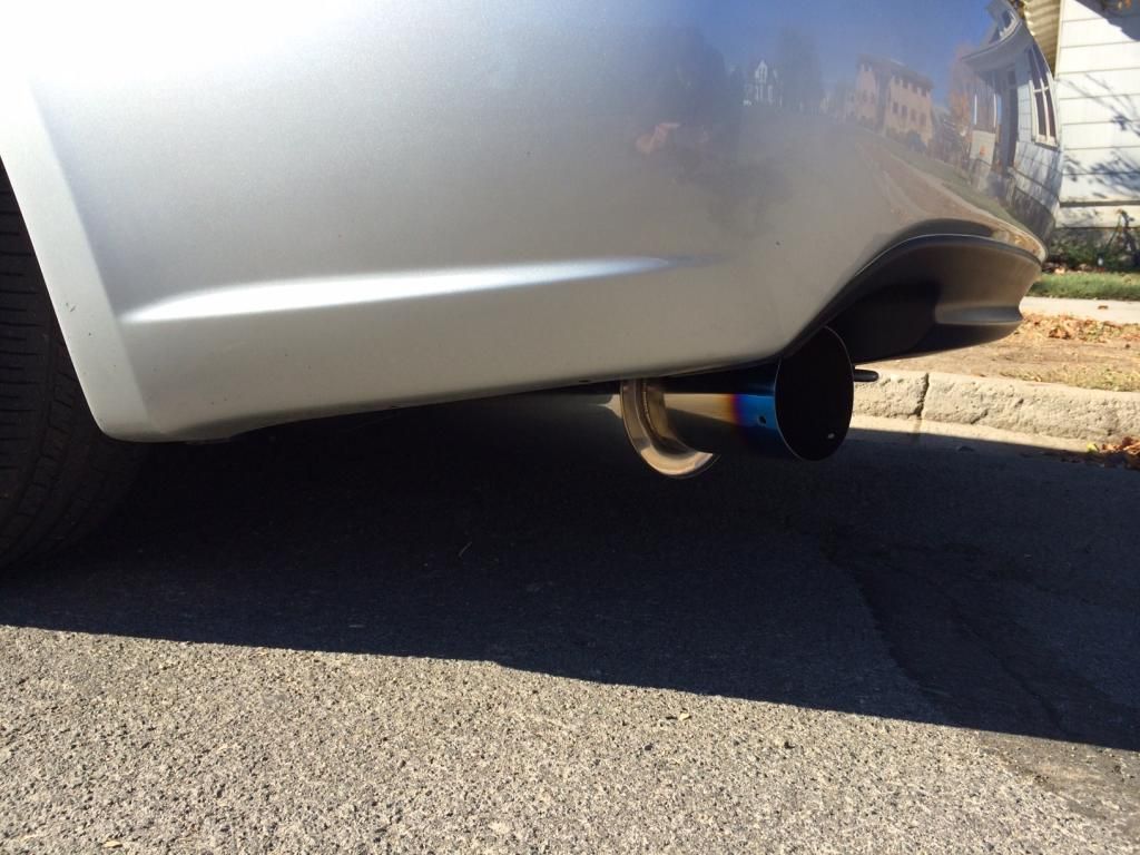

Sold my WRX wagon in pursuit of a Legacy GT 5MT and today I picked one up. It's a 2005 SWP w/ Limited Black Leather and an 06 STI Swap...unfortunately the car has some engine issues that have yet to be determined but I plan to swap the shortblock and get this back to where it needs to be...
Current Mods:
Engine:
-vf39 (will be replaced...:/)
-Modded Stock Injectors (thinking DW 850cc or bigger for e85 down the road)
-Walbro 255lph Fuel Pump
-TGV Deletes
-Godspeed 3" turbo Inlet (May go Perrin)
-Greddy Uppipe
-Invdia Downpipe
-AutoSpeed Catback Exhaust
-Killer B Oil Pickup
Suspension:
-BC BR Coilovers
Brakes:
-StopTech Pads
-Drilled and Slotted Rotors
Drivetrain:
-Kartboy Shifter Linkage
-Kartboy Shifter Bushings
-Kartboy Short Throw Shifter
-Spec Stage 2+ Clutch
-Spec Lightweight Flywheel
Interior:
-6K Interior HID's
-AEM Boost Gauge
-AEM Ugo Wideband
Exterior:
-Cleared Headlights
-6K HID's
I've been putting together a list of what I need to have this back on the road and though I have considered a built shortblock I am thinking I will just buy a new OEM ej257 shortblock and build it from there...the current engine showed signs of metal in the oil so I am going to replace anything that oil touched... I might as well get a new timing belt and water pump while everything is apart as well as every gasket and refreshing the heads...assuming there has not been damage there...
Here are all the pics I have at the moment...there will be a lot more added to this thread as the tear down and reassembly are underway...hoping to borrow a cherry picker and get the engine out over the weekend...tearing into it a bit will let me know where I can afford to go with plans, turbo, etc.
Sorry for the weird cropping...I saved them on the iPhone and it sometimes does that with pictures...I'll fix that once I get the pictures uploaded to photobucket and all that...
