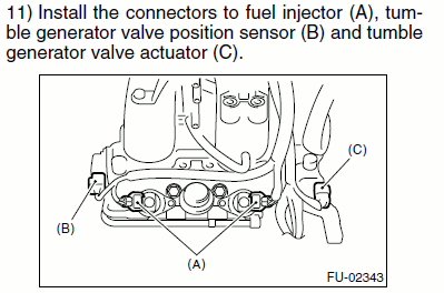

There are only two, not four.
It is said that the throttle position sensor is identical to the TGV sensor but don't count on it - it can depend on model year and market.
As for the sensor - it's not specified in the picture you provided, but it's opposite to the actuator designated 14120/14120A. The one opposite to 14120A is easily accessible from the front of the engine while the other is trickier to access.
I hope that this helps.
Also see pic below:
Also see pic below:
Ok so the part numbers on the picture I provided are for the actual motors and not the position sensors?
Where can I find a part number for exactly what I need then?
