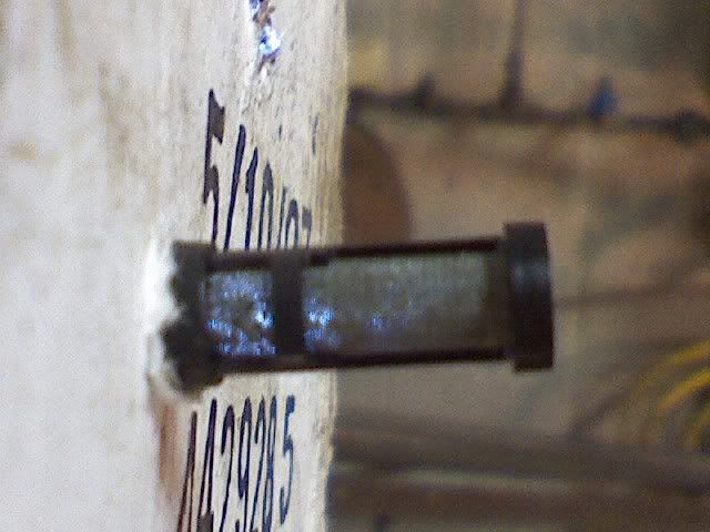

I finally got around to pulling both of the Banjo filter bolts. The turbo one was about 50% plugged. And the driver side ACVS unit was 25% plugged.
Pic. of turbo Banjo filter. Over 73k on my GT

The deposits are largely due to degraded oil and not the filter falling down on the job. I've cut open a number of filters over the years and none of them looked clogged. This includes Amsoil EAO filters with 15,000 miles on them.
