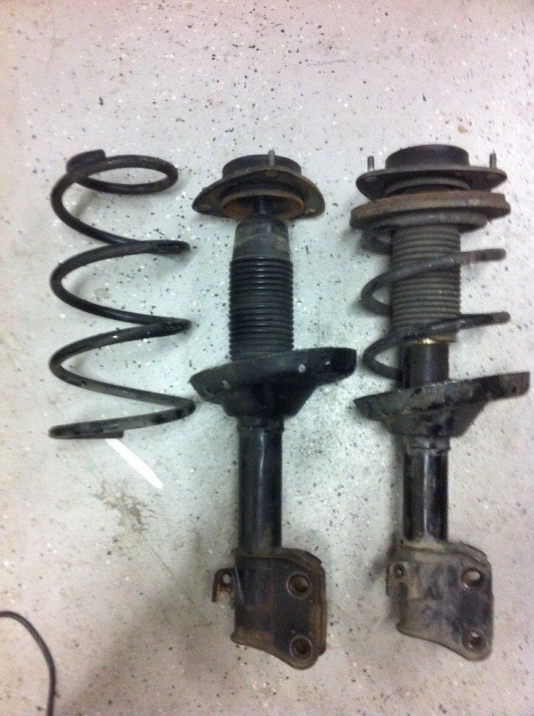

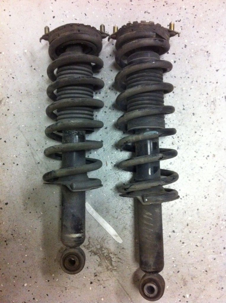

Sorry for the wait but I have a few pics.
The rears Id say its ovious the springs are different lengths. You can just see that its different and the outback one has more coils:
For the fronts since my outback ones didnt have all the hardware its hard to say, but they might actually be the same but im not 100% sure:

#9: 03-04-2012, 01:37 PM
 Benjineer06
Benjineer06's Avatar
Location: NW Illinois
Car: 2005 OBXT Stg 2
Posts: 28
Send a private message to Benjineer06 Find all posts by Benjineer06 Reply With Quote
Thanks. That answers the question of being able to put aftermarket LGT wagon springs on the OB struts. The rears would be dropped further than the front due to the differences in stock spring length.

#11: 03-04-2012, 10:37 PM
NOW we're getting somewhere: rears
 Impatient
Impatient's Avatar
Location: DFW, TX
Car: 09 base --> 07 OBXT LTD 5M
Posts: 224
Send a private message to Impatient Find all posts by Impatient Reply With Quote
Stating the obvious, on the rears, looks like the overall height difference is due to 1) higher perch, and 2) longer spring.
But from your picture, I would guesstimate an inch of it is due to the spring, and the other 1.5 in is due to the perch height. (Isn't the ride height difference 2.5" total??)
So if someone put the leggie spring on the outback strut, they would reduce height, and travel by 1 inch. Sound reasonable???
This assumes same spring rate. Are the wires the same thickness? Anyway you can measure (micrometer??).
ONE MORE THOUGHT: If someone started with an Outback spring, and cut off 1/2 a coil on the bottom, would they end up with a Legacy spring equivalent??
Regardless, thanks for providing the pictures.

Still a ways to go deciphering the fronts
 Impatient
Impatient's Avatar
Location: DFW, TX
Posts: 224
Assuming again a 2.5" difference between Legacy and Outback, I'm thinking the strut does a bit more than 1/2 of that, so the spring must do the rest. So the spring might be softer, or shorter. Can't tell from this picture.
There could be other factors at play, but can someone lend their opinon after looking at these pics: OB Struts are ~ 1.25-1.5" longer from lower mounting holes to perch. The remaining ride height difference (ASSUMING 2.5") must be due to shorter/softer Legacy spring.
Or what???

#13: 03-05-2012, 05:47 AM
 whitetiger
whitetiger's Avatar
Title: IDGAF
Location: Bergen county, NJ
Car: 2013 NC3 CLUB, 05 OB 3.0R
Posts: 8,857
iTrader: (38)
Send a private message to whitetiger Find all posts by whitetiger Reply With Quote
is it possible to take pics of the springs alone, not installed on the struts. i ask because when a spring is installed, it is preloaded and compressed some. the best comparison would be just the springs alone.
