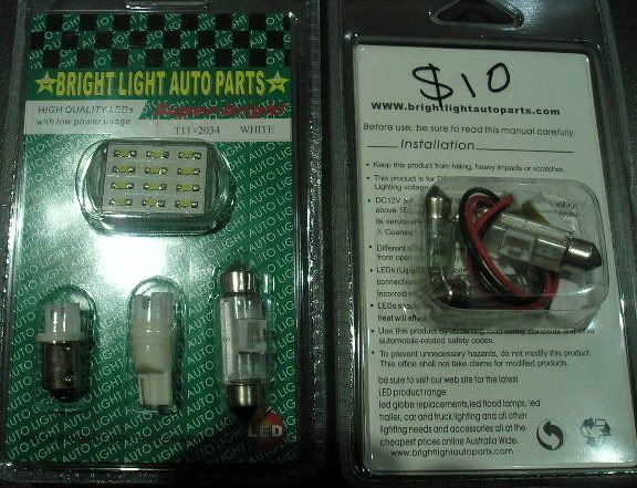

I have converted the Map Lights to LED using an item I found while browsing at an Auto Lighting shop.
I got two packs, used the 31mm festoon connector (of the seven different connectors supplied) and then did this:
Removed the incandescent bulbs (8 watts) and inserted the 31mm festoon connectors.
Fastened the 4x3 LED Array in the Map Light cover using the double sided foam provided in the kit. Tucked the excess wires up behind the festoon connector into the roof lining.
The light level is improved and certainly works well with my light coloured alacantra leather interior.

I also used the same 4x3 LED Array to convert the Dome Light as follows:
I joined two 4x3 LED Arrays. Staggered the positive and negative connections, soldered and covered with standard insulation tape.
Removed the standard incandescent bulb (8 watts) and inserted the 31mm festoon connector. Tucked the excess wire up into the roof lining. Fastened the Arrays using the double sided foam supplied with the kit. The slight angle of the surface where they are fastened actually helps to spread the light.
Tested the install before replacing the cover. Initially, the polarity was incorrect and the LEDs did not work. Simply removed the festoon connector and re-installed in the opposite direction. All worked fine.
Replaced the Dome Light Cover, and there you have it. Much better rear illumination and lower power consumption (approx 4 watts for both).

Also did a similar conversion in the trunk (we call it a boot in Australia):
Removed the power from the rear of the trunk light before starting and let cool. A 5 watt incandescent bulb can actually give a nasty burn if it is hot!. Then removed the cover and bulb. Threaded the small connector through the rear of the Trunk Light assembly. Connected using the wedge connector provided in the kit. Tested to ensure the correct polarity. Needed to remove the wedge and re-insert in the opposite direction. All worked fine.
Replaced the cover as it will help to prevent the wedge from coming loose. Trunk Light is much brighter and more centrally placed. Yes I know it is crooked, but it is installed in a place that you cannot see. Next time I will pay more attention to the alignment. Additionally, If one 4x3 LED array is not enough light, you can join two and add more light without exceeding the original circuit load (5 watts original, 2 watts for each 4x3 LED Array).
