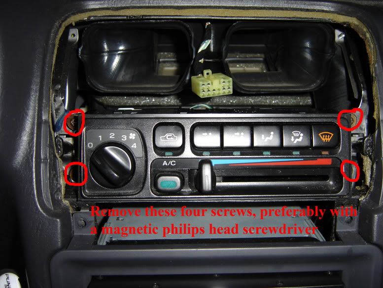

4. Now its time to get a little frisky with the car. First did you Disconnect the battery? If you didnt do it now, you dont want to short out any more lights, or anything else. Whenever you mess with anything electrical on your car you should disconnect the battery. Alright, back on track. Remove the plastic faceplate that surrounds the controls and then disconnect the hazard switch, shown below
5. Next unscrew these 4 screws to loosen the Heater Control Unit, this is where the magnetized screwdriver comes in handy, you dont want to lose these.
