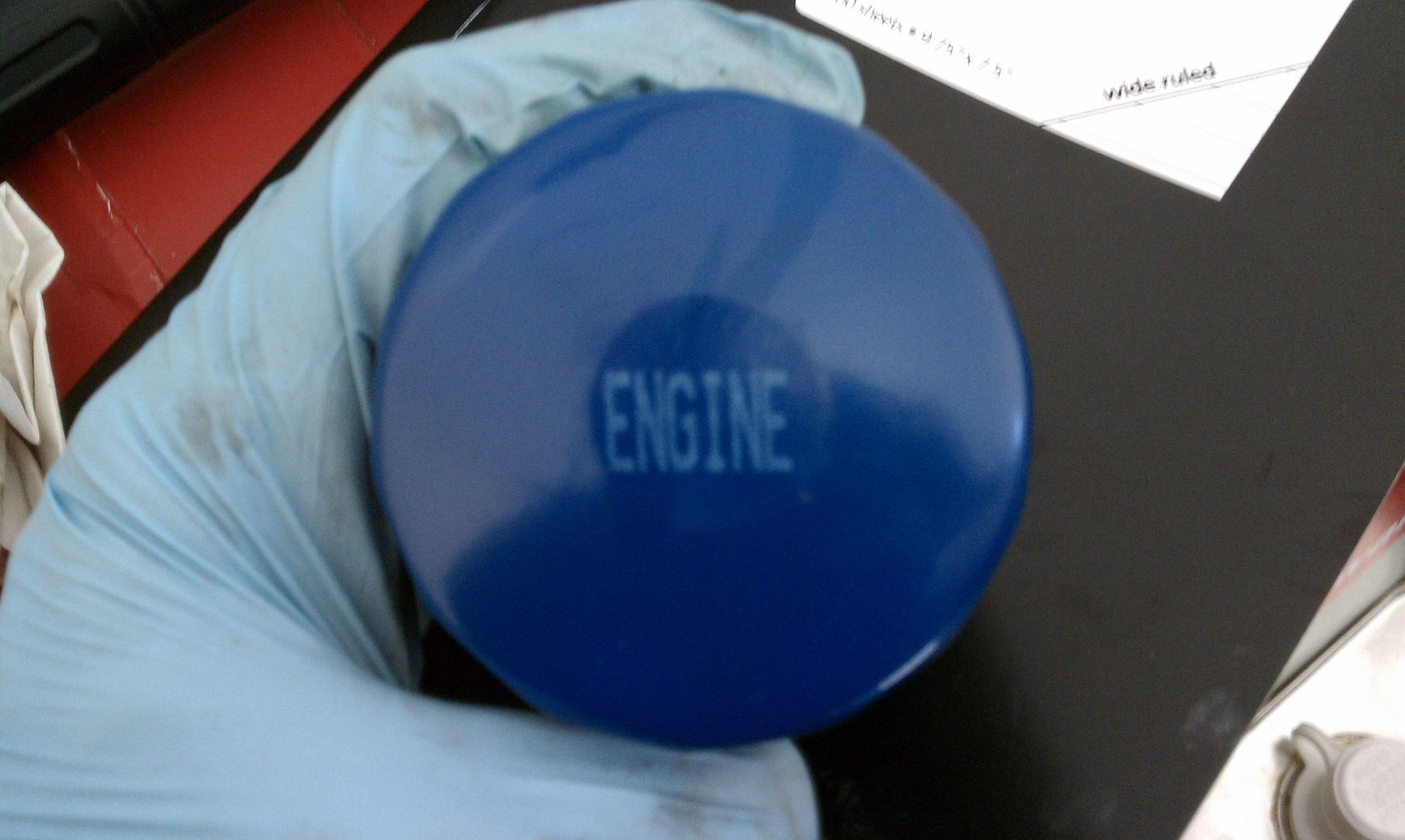

Now many may ask if it is necassary to replace the crush washer or gasket (as Subaru calls it). This is kind of like which oil should I use question. I never did on the other 2 Legacys and the Haynes manual doesn't even mention. However I will on this car as this is a very new car to me and I plan to do everything in my power to take care if it. Also as I pointed out the filter and gasket from Subaru cost next to nothing. *The gasket/crush washer SHOULD be Replaced EVERYTIME. Subaru was kind enough to label the filter so you don't forget what you're doing
