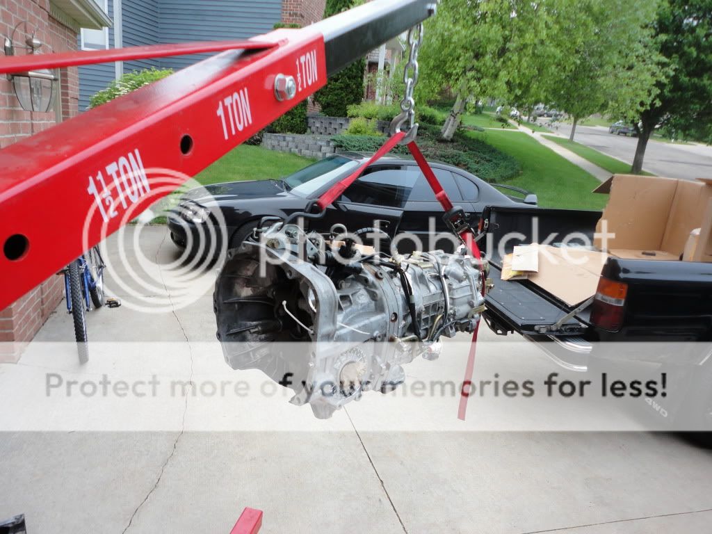

2006 STi motor
My car looks on its future 6mt. I wanted a 2006+ for the better syncros and bit better gearing. The 2007 gearing would have been ideal but the final gear is the same and I don't care about drag racing, only in school zones. I previously had a 2004 six speed so this will work just fine.
