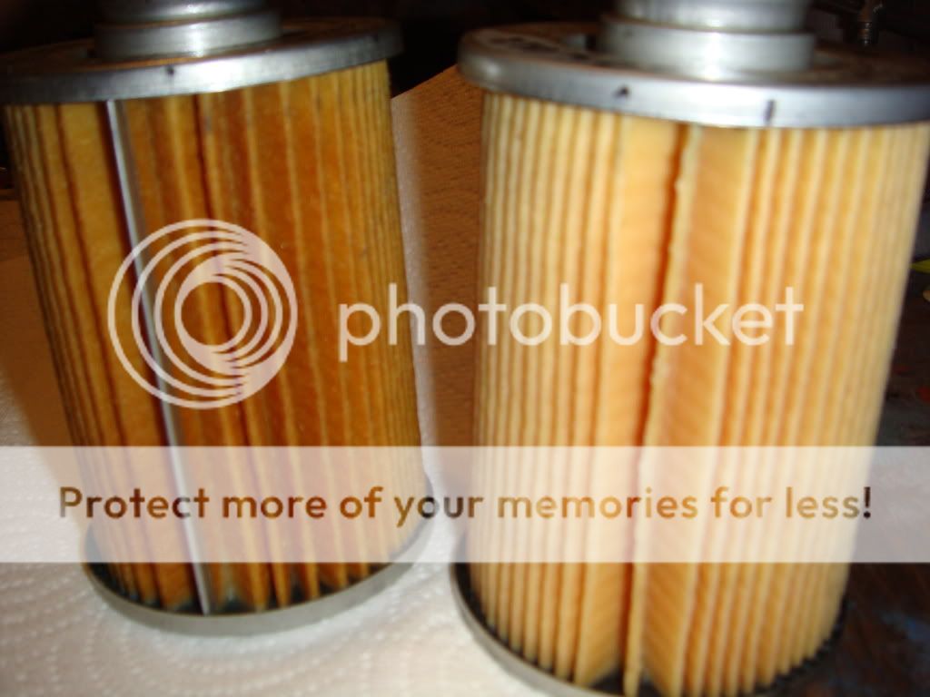

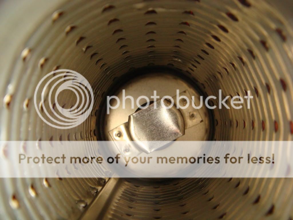

Two other interesting things about the D+ is that the center tube is of a different construction, and the media ends are joined with a metal clamp rather than just glued, as in the others:
D+ Spiral tube
P1 and Puro Classic vertically seamed tubes
Media seams
On examining the media, all three had about 60 pleats (57, 58, and 60) all of the same depth and height. The Purolator Classic and PureONE measured about .022” thick, the Bosch Distance Plus was about .030” thick…Considerably thicker and stiffer. Looks to me like it will hold more dirt for long usage.

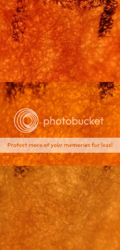

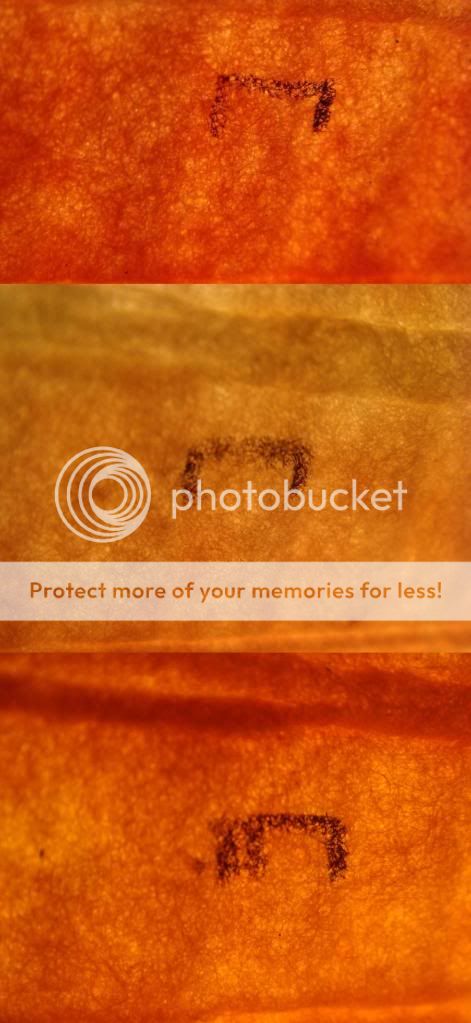

The Bosch media porosity seems somewhere in between the PureONE and Classic, but it’s hard to tell since it is thicker and lets less light through:
Top to Bottom - Classic, PureONE, Bosch D+
Extreme Close up… Top to bottom here is – Classic, Bosch D+, and PureONE
