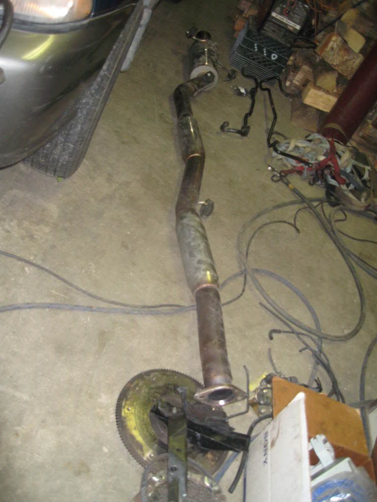

parts I got, and a catback 3in SS exaust for 150$

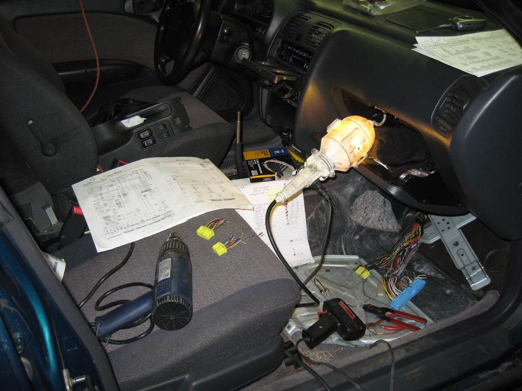

I adapted my 2.5 engine harness to the V4 engine and then I cut my ecu connectors, after 6 hours I finished splicing the wires to the new ecu.

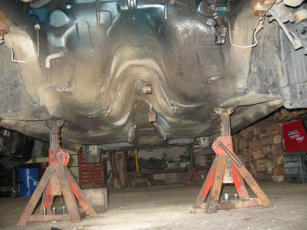

took everything outta the car

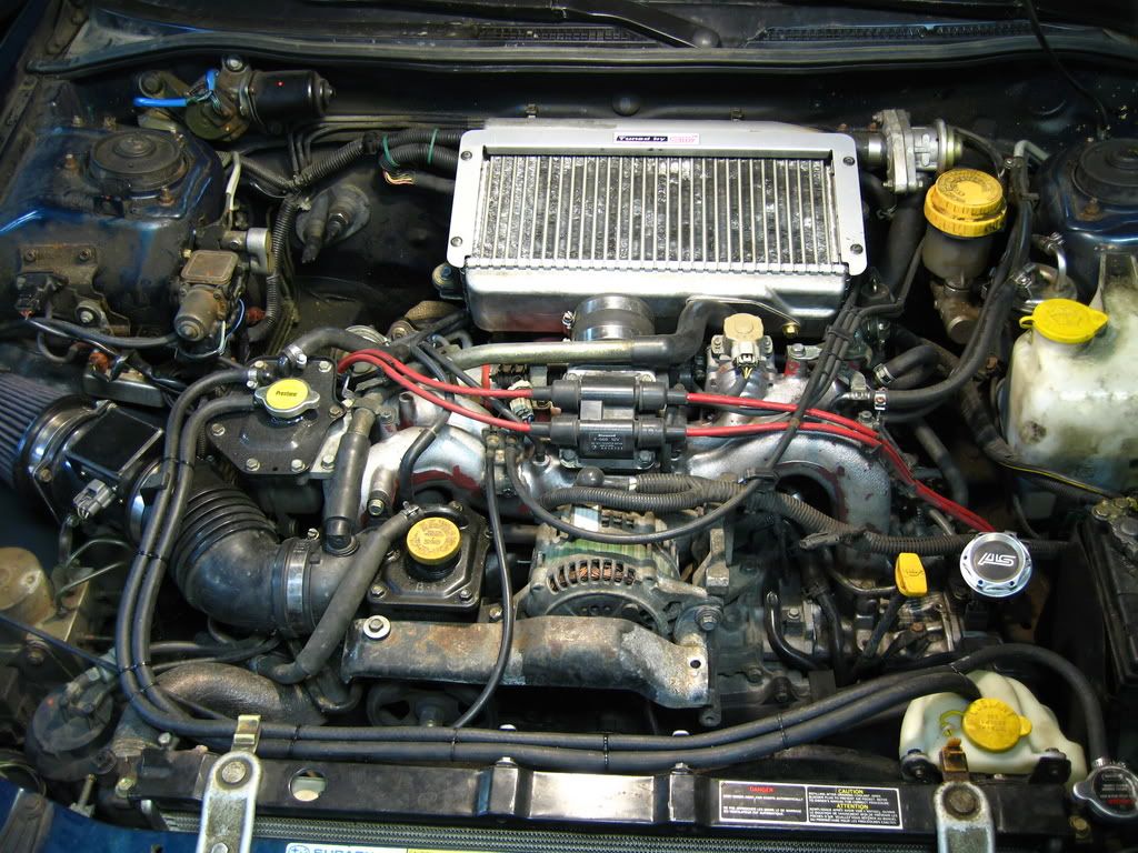

then I put the new powertrain in....
relocated the cruise control vaccum pump and actuator

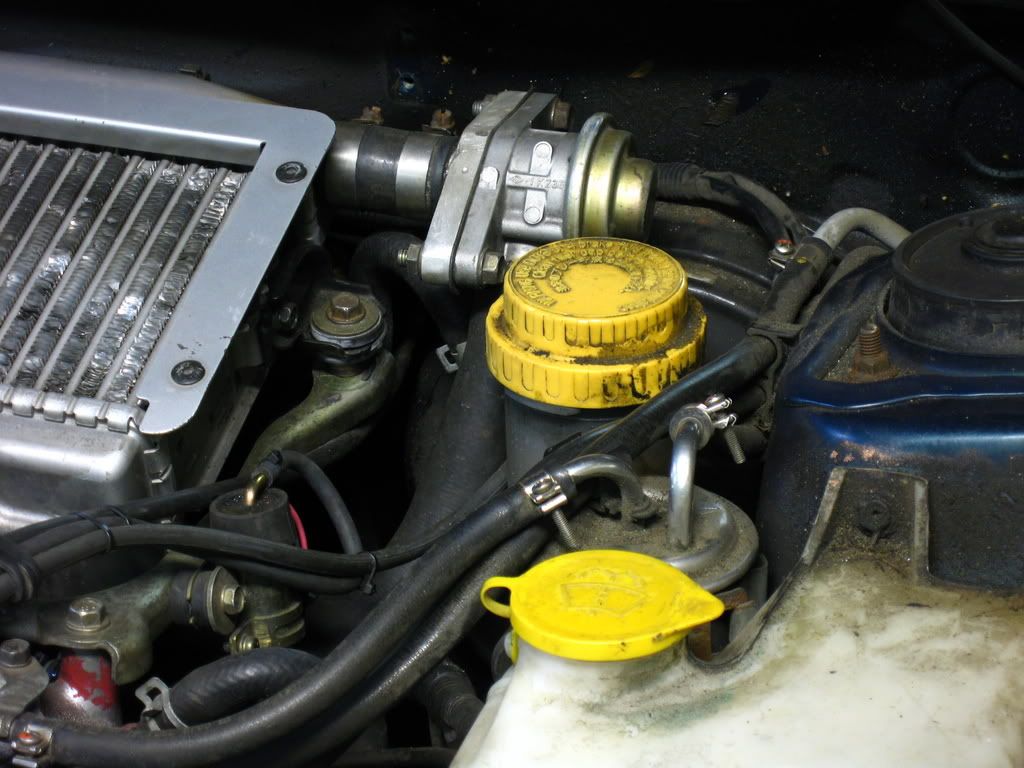

I had to cut my clutch reservoir and relocate my bypass valve since I am using a V6 tmic. you can also see the new location for my wastegate selenoid. I put it there since I used the original EGR wires to hook it up.

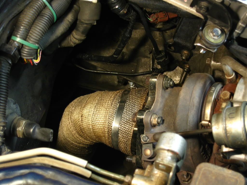

got myself a cheap 3in bellmouth down pipe mounted to a TD05

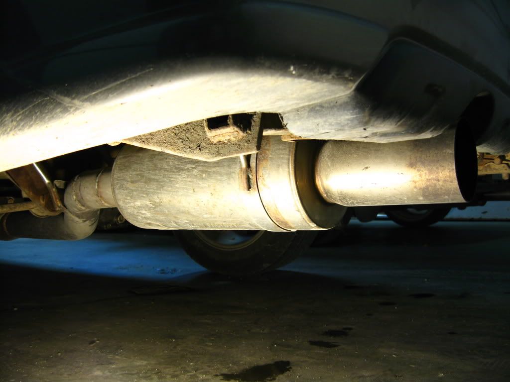

installed my exaust, 3in turbo back and it makes an awsome sound
finally.... heres an Outback you dont see often
...Conclusion all that is left is changing the gears in the rear diff. since its wienning like crazy and and getting my STI suspension. No problem with the engine what so ever, it runs great and cant wait for the break in period to be over.....;-)
